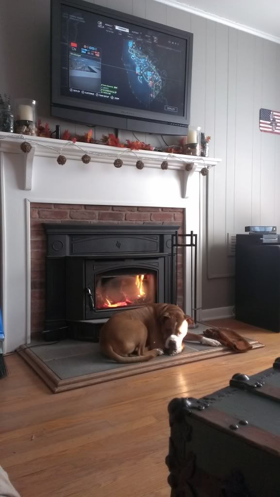

So the stove is in! Had 2 break in fires, going to do another one tonight. I think it looks great. The only thing is I have to redo the trim, we tried to match the floor stain but I want it to match the mantle which is dark.

This is right before the install. The mantle is on, the electric is buttoned up (put in a new outlet in the mantle). Had to cut about 8 inches off the depth of mantle for it to fit. This is the original mantle. I also sealed/enhanced the slate.

After the install, before trim:

And all done! (Minus redoing trim doh!)

Ignore my wiring mess, I have to clean that all up now. Thanks for looking! I am very very pleased with how it all worked out. Even the installers were impressed. With this project a success my wife has decided I am capable of redoing our master bathroom...lol.

That picture is great! Our dog is warming up to the fireplace, no pun intended ha. Still investigative about it but I think he will be lying like yours soon.
