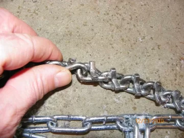

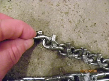

+1 on what Robc said, also see if they make them for your tractor with the v-grip.

I also got the 2 link v-bar set for my Cub GT with turf tires, and now I have no real problem grinding through some pretty deep snow piles while plowing. I may end up getting a set for the front too, since the front likes to slide quite often.

Yep, definately get 2-links, worth the extra money for sure. I havent used the V-bar but if I were to get another set I'd give them a try. The link you posted about has them for sale...

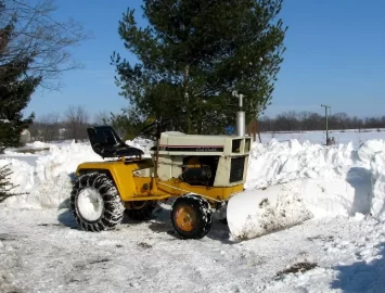

I attached a pic of my snow removal tractor... had the tires filled last year when I took the pic but no weights on it then.
