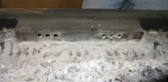

Is the boost air manifold in correctly? This is the L shaped angle plate that hangs at the bottom front of the firebox. It can get put in upside down which will block the boost air flow. The blank part should be on top with the other face with the holes, pointing toward the back of the firebox.
This is the part out of the stove.
[Hearth.com] Reality Check
This is what it looks like when installed in the T6. The hole pattern varies with the model and year of the stove.

air intake properly installed
