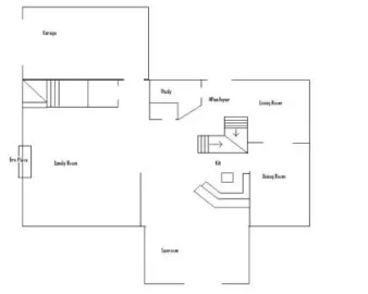

Below is a key plan of the house, it’s pretty big, almost 3500 square feet not including the basement, which is another 1800, there’s also a stand up attic that’s not shown and is just used for storage and is closed off, that’s another 800, 9 foot ceiling throughout the house even in the basement. It’s a fairly open plan with no walls between the family room, sun room or kitchen….living room and dining room also open but not used much. Air flow to the second floor should be good since the foyer is open to the second floor and there’s a second back stair case to the second floor just to the side of the fireplace in the family room. There are masonry fireplaces in the family room and in the basement (one on top of the other and the one in the basement has never been used). There is also a gas fireplace in the master suite. There are ceiling fans in the family room, the sun room, and in the master suite upstairs. There are lots of windows and not just in the sun room (wife went a little crazy and almost every wall on the first floor has windows). Current heat is 2 zone heat pump with gas backup (2nd floor one zone, first floor and basement on another zone (with thermostat on the first floor). Air flow and or exchange between the basement and the rest of the house seem to be restrictive since it’s only by way of a stair case with a 90 degree turn.

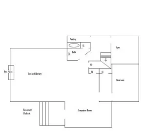

My worry is about the basement, it’s on the same zone as the first floor. With an insert heating the first floor and the thermostat on the first floor I see it getting cold down there and since I telecommute from home a lot I spend a lot of time down there. When I had priced an insert the year before last the salesman was trying to sell me on a second smaller insert for the basement since I spent so much time down there…thoughts anyone?
