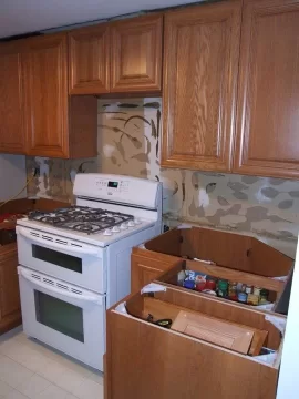

firefighterjake said:Update . . . As mentioned I was and continue to be pleased by the construction and attention to detail . . . the cabinets we picked out (Red Oak) are apparently built in China but they seem decently made with plywood sides (with veneer) and the front doors, face frame and drawer faces are solid wood. Drawers are also dovetailed joints. The doors themselves come pre-hung to the face frame and the drawers we purchased are already built -- you just attach the soft close sliders and the front drawer front and they're done.
Originally I was going to exceed the manufacturer's directions by using a thin strip of wood glue on the joints, but the salesperson said while I could do so, Cabinets to Go says this product can be built without glue and it still has a 30 year warranty so I opted not to use glue. In the end I found the cabinets actually seemed quite rugged with little to no flex while moving.
Putting them together was wicked easy . . . the salesman said it would take 10-15 minutes for each upper and lower cabinet with the exception of the lazy susan corner piece and he was dead on accurate in his estimate. I used both a flathead screwdriver and a cordless driver (for parts that required screws such as the corner brackets and slide mechanisms. Honestly, putting these together reminded me of putting together those cheap, press-wood cabinets . . . the ones that go to together wicked fast and easy, but fall apart in a few years . . . months . . . weeks. All in all I was impressed with how quickly these were assembled and the ruggedness of the box . . . although as I said one could opt to beef them up even more with some glue.
I did have a few negatives . . . some of the written directions were a bit vague and there was a serious lack of illustrations to show what needed to be done . . . some assembly was educated guessing. This was perhaps the one thing that could use some tweaking. I also would have added more brackets -- or at least something more rugged thant he plastic brackets sent with the kit . . . then again the firehouse recently put in some decent Merrillat cabinets and they had the same looking plastic brackets. Finally, I would be careful if buying cabinets . . . not all the cabinets were the same . . . some did not have dovetail joints for example and some did not seem as solidly built in my own opinion...

However you make it sound like the construction is not so bad. I'm quite pleased with the construction . . . I would say it's no better or no worse than most mid-level cabinets you would purchase. Uses cam locks for the most part to tie things together along with plastic corner braces . . . which is comparable to many cabinets I looked at. Drawers on the particular model I went with had dovetail joints . . . something I was looking for in cabinets.
I could put them together one day and hang them the next maybe?? Depends on how fast you are and how good you are at hanging cabinets. Most of the uppers and base cabinets I can put together in 10-15 minutes. Instructions aren't all that clear, but once you get one done and figure out how they go you can whip through the rest in record time. It helps to have an impact driver or electric screwdriver. The corner lazy susan cabinet took us a bit longer -- maybe 30 or so minutes.
