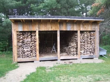

I was taking some pics the other day . . . figured I would snap a pic of my woodshed in the Spring . . . before I fill it this Fall. This is the wood I was left over with . . . should be nice and well seasoned come Fall. The wood I will stack this Fall in the center of the woodshed will then be used last . . . and with any luck will be the wood I use two years from now.

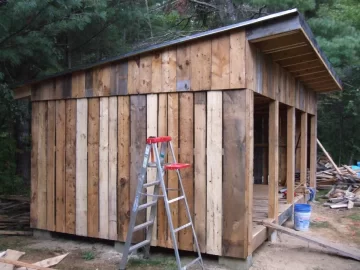

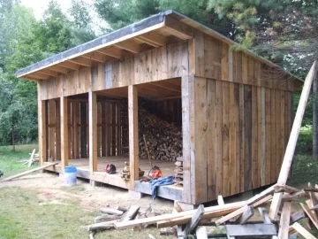

Ask and ye shall receive . . . taken shortly after I built the shed . . . so it isn't full of wood unfortunately.
  • RE: Left over wood
I should also point out that my brother-in-law from CT and I also modified the woodshed . . . there is now a 4-foot wide attachement on the back with the roofline continuing to drop . . . he stores his two (well two of his three) snowmobiles in the new addition.
FFJake - Thanks for the photo - what kind of roofing material did you use? Shari
Shingles . . . some new . . . some old that were still in decent shape from the camp that I tore down . . . the camp incidentally which was what I got maybe 2/3 of my wood from to build this shed.
The shingles were different colors, but I figured what the heck . . . it's just a woodshed . . . after roofing the shed I had the brilliant thought of spelling out something with the different colored shingles . . . something like "SOS", "HELP" or "GOT WOOD" . . . of course this was after I was done and then it was too late.
The snowmobile addition roof is a bit different . . . it uses sheet metal (aluminum actually) that was pulled off the old camp . . . the nail holes were plugged with silicone.

Not smarter . . . I just tend to over-build things . . . figured with a relatively low-angle on the roof that I wanted more strength . . . plus in tearing down the old camp I had plenty of 2 x 4s so it was easier for me to build the shed out of 2 x 4s and go with stud walls rather than go with the 4 x 4 or 6 x 6 post concept . . . in fact the "posts" you see at the front of the shed are in fact 2-3 2 x 4s spiked together.

I figured it holds between 9-10 cords of wood. The outside dimensions are 12 x 20 (but I deducted some for the walls, space between stacks) and I stack 6 feet high on average (probably a bit higher in places).
