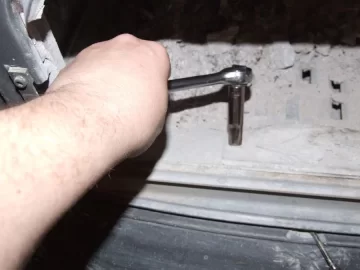

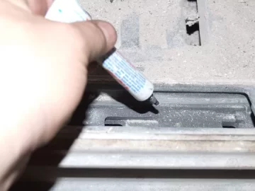

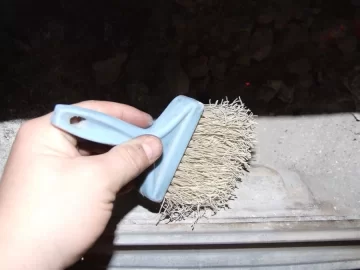

The Problem: Ash gets into the doghouse where the air control is and makes it so that the air control lever does not move as easily or it binds up, making it a little harder to open and close the air control. Rather than resorting to using a 5 lb. ballpeen hammer to move the lever, try this fix.

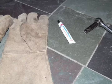

Tools You'll Need: Gloves if the stove is still hot, 10 mm socket and wrench, graphite powder from local hardware store, brush or something similar to move away the ash
