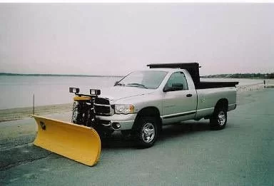

I had timbrens in my old truck that had an EZ Dumper insert so heres my .02 on the subject. Timbrens are a cheap fix to your problem but you will likely regret them after riding in the truck. On my truck there was about 1/2" of clearence from the timbren to the axle tube. When hitting a bump with no load, once my suspension cycled that 1/2" it hit the timbren and that was it for suspension flex. This resulted in a jarring ride that I did not care for. When loaded the truck sat on the timbren and the ride was better but not great.
Air bags on the other hand can be inflated to whatever pressure within there psi range to achieve desired results. Empty load = empty air bag = factory ride from suspension. Full load = psi accordingly = controlled ride. I will be adding bags to my truck in the near future. I have an aftermarket suspension system that provides an all around better suspension for daily use. And while it does not affect my factory payload rating the rear springs have more flex which equals more squat under load. Air bags will correct this and allow for the best of both worlds.
Old set up.
