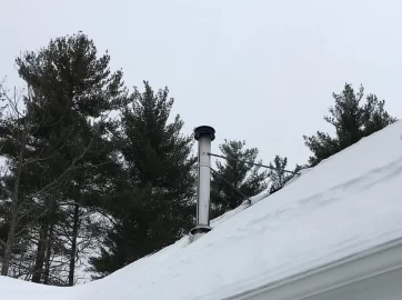

Here is a photo of the upper portion.
I can't answer what class it is.
Looks like class A to me.. If you have a ways to support it above the stove you could disconnect it, slide it up, remove your stove to install elevated hearth. Then slide it back down and reconnect.. then you could either leave the chimney height the same (meaning it would be 6'' higher) or you could possible remove the last section of chimney as long as your above the peak..
The chimney will be pretty heavy to slide up and support while you are raising the hearth so make sure you awear of that.. also you will have to wait till the snow clears because you will have to get on the roof to loosen support bracket and storm collar so that the chimney will move.. is there access to all sections of the chimney in side?
Yes definatly class a that is easier if you can handle the weight and support it somehow you could lift the chimney as a unit.
