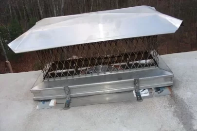

My cap has a wire mesh screen with large opening. I start my fire with paper. I burn to 650 degrees everyday. It has never clogged. I think your problem is a combination of running the stove too cold and the fact that your openings may be too small.

Totally plausible. Every setup is different. My recommendation to the original poster is to use a larger opening wire mesh screen as shown in my photo. You can buy this stuff at your favorite color box store and it is real easy to bend up to the shape of your cap and secure.

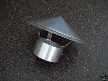

I have seen a lot of people running caps with screens that are simple a piece of sheet steel with openings punched out. They are much more problematic and easier to clog as there is much more metal surface for contaminants to stick to and begin clogging. If it is a real problem, then run one like this:
  • [Hearth.com] rain cap
I would not use a cap like this. It clogs much more easily. If yours looks like this, then try the wire mesh.

that is the same desighn i have on my flue. now with out the wire mesh. hope it helps cut down on clogging.
I'd be tempted to take side cutters to it and double the size of the openings.
mine looks like the first one with the witches hat
