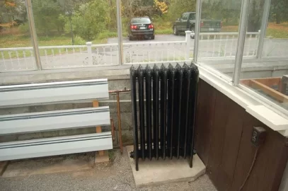

Here's one I refurbed last fall and put in the greenhouse. Note the lion design.
I've only done old rads, but I doubt there's much difference (other than the price) for new ones. Around here, you can pick up old radiators for around $100 each, sometimes a lot less (like $0) for just hauling them away. You have to be careful not to drop or crack them. It's always a good idea to pressure test them before making all the effort, if possible. It's also a good idea to flush them out. Old steam rads are the worst--they usually have decades worth of rust and other crap sitting in the traps near the inlets and outlets.
If you're looking for rads for a hot water system, be sure they have a "top pipe" which is the channel connecting the columns on the top. If you look at the rad in my kitchen, you can see that there's no way to vent the air when filling it. A radiator half full of air isn't going to work very well.
