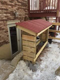

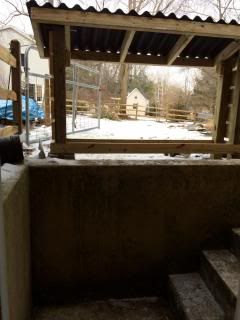

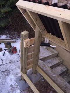

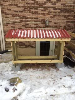

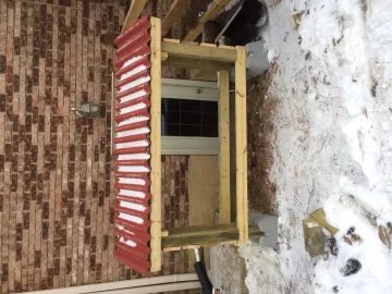

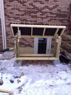

Hey all. With all that impending weather last week I hurried up and built this before the ice hit. As you can see in the picture I have cellar steps that lead right to the wood furnace. Wanted something I could just reach out the door for when I wanted to add more wood. Because the steps are already approx. 3' below grade I couldn't make the rack too high or the boss would never add wood to the stove if I wasn't home. That left me with about. 36" to play with in rack height. I needed to load the rack from the back side and with the roof cover I imagined it would get old bending over the whole time you loaded so I made the roof hinge up to make the rack more ergonomically accessible.
