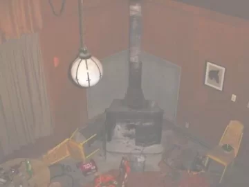

This place was a real dump when I bought it two years ago. Talk about a fire hazard waiting to happen. Hopefully this pic will be light enough to see the mess around the old Franklin

I had the same type of stove. Search on my name and you'll see the pics. Loose that like bad habit.

Yeah that Franklin is gone. Stored it underneath and will maybe use it when we add a downstairs. Note the box of Match Light on the floor, ash all over the place. In one of the back bedrooms there were propane tanks for a grill and numerous boxes of ammo.
