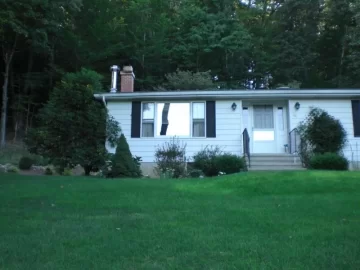

I need a new roof on my 1977 modular built home with a 4 pitch roof. The roof dimensions are roughly 27 x 54 and it is a truss design with "rafters" 24 inches on center. Long story short with all the snow we had last winter and coupled with rain that we got last February, the decking is soft when you walk on it. It doesn't sag but when you put some weight on it (220lbs), you can feel that it has a little give. You can feel where the rafters are because it is rock solid but if you step right in between you can see it move. . I have had several roofers up here and gotten different advice from all of them.
I want the roof overbuilt
! I bought the house in 2006 and had planned on replacing the roof in 5 years. It’s the old 3 tab design and probably 15 years old at this point. I have no leaks and no water penetration so far. I have taken pictures of the roof and nail holes and no black rings or evidence of moisture anywhere. My main issue is the decking or the subfloor. The decking needs to be replaced. It is half inch plywood which is code for 16 inch rafters. Just about everyone I asked has given me a different opinion on replacing the decking.
My question is can I lay another layer of decking on top of the old? I have read online that with this design it should have three quarter inch decking or even one inch. I have gotten quotes to lay half inch over the existing plywood (if any are water damaged they will be replaced) and the last company I got a quote from said that putting a second layer down was a bad idea in that it would trap moisture and cause the roof to fail. Other people have said put down half inch or five eighths and I should be good to go. Ironically the company that wants to rip up the old decking and put down three quarters tongue and groove gave me the best price overall. They have all pretty much said that I can wait till next year if I want as none of the shingles are in bad shape yet. Sorry for the long rant but any advice will be greatly appreciated as this is going to totally wipe out my savings which will stress me out a bit.
