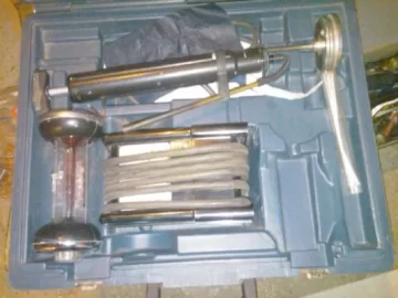

Using the proper manometer tools as shown below and then he fills out a tag as shown below to show he has done his job!
By measuring the draft he can set the Oil Burner to let in the appropriate amount of air to burn for complete combustion.
Then by using a white strip he can insert it into the hot flue stack to see if there is any smoke.
If there is smoke, then the chimney will soot up, and the more sooty it gets the faster it will get even more sooty!
So after cleaning the boiler and checking the adjustments he should read 0 (Zero) smoke and right that on the tag. (See red arrow)

See pics below of proper tools and tag with date the work has been performed!

I picked up one of those kits for $35 at a yard sale. Works great, but still kind of sketchy compared to a good combustion analyzer. Anyone can fill in a card so in that case you really have to trust your tech.

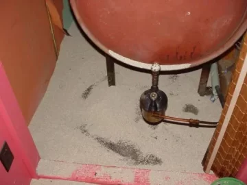

The guy that did not put my oil tank filter back on tight is also not coming back!
See pic below! Luckily my oil company has AIG insurance because after the hazzard spill company came, they had to pay $2,000 to fix the wall and put in a new door to the garage!
So now I have a new steel door to the garage per building code and not my old wooden door for free!!

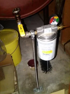

Since then I had a Cartridge Filter installed that I can change myself just like a car filter by also installing a ball valve!
Guess what, I can buy the new filter at Home Depot for alot less than the oil guy charges!!!!!
The new oil reduction guage tells me when to change it, approx every 2 years!! More savings!!! ChaChing!!!!

That spin on filter with gauge looks nice. Just wondering why you need a ball valve.It looks like there is a Firematic shut off valve right out of the tank.

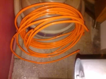

Also it looks like you have unprotected plane copper tubing buried in cement, in Mass my understanding is that this will not meet code.
I have the same thing, I will replacing mine with the plastic coated tubing.

I agree that the analyzers are not going to be a once a year item for most homeowners. You can do a very good job with the bacharach kit as long as everything is taken into account. Smoke test and stack temp are both critical, but can and will vary depending on the cycle length of the boiler. Its easy to tune a boiler for max efficiency when the minimum cycle time is 20 minutes (like when the indirect fires or its 10 degrees outside) but almost impossible during the shoulder season when 3-4 minutes of your boiler's peak demand is all that's needed to maintain your house, so most techs dump heat into all the zones (some don't even do this) and get it running for 5-10 minutes check the stack temp, adjust the air and forget about o2, co2 or any gas analysis.

The ball valve is so much easier to turn than the Firematic, in fact they want them on new installations before the firematic so if the firematic goes it can be changed out real easy! That Firematic is so old I do not want to touch it!!! Now I do not have too :)
Yes, that is bare copper in the concrete. I did some work for my neighbor and he gave me a piece just long enough to run along the floor. Just have not had time to install it yet !! See pic
