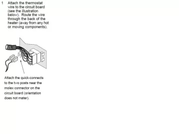

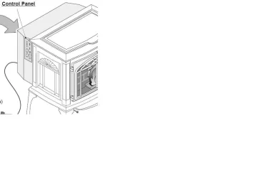

Does anyone know where the circuit board is that the thermostat connects to? The owners manual shows the connection to it but doesn't show the parts breakdown for me to know where it is. Is it behind the control panel?
Hello Doug
I own the big cousin stove, the Avalon Astoria however the control panels are almost the same.
So my educated guess is that the Thermostat connector lugs are on the back side of the control panel just like mine.

Thanks Don222. That is what I suspected but didn't want to take anything apart unnecessarily. I was going to use the thermostat that came with the stove.
Lebondj1.
Don2222 is correct. The control board where the thermostat connects is on the left side (where the external control buttons are).
