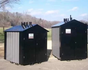

, sizing depends upon home size, btu , location etc. People should call and not go just by the specs online. Going larger is advantegous in that it takes longer log size etc. More thermal mass is always going to retain heat longer. these units are built out of 1/4" boiler plate and will get a true 18 + hour burn time out of them. These units have NO cataylic converters to burn out, long exhaust travel, Low emissions and burn 50% less wood to heat 100% of home,business, hot water. Demand is huge. see video at www.WoodGasificationFurnace.com
As a Seller of these, I will be Happy to answer any questions about either the E3300 or the E3400

Anyway, glad to see they are EPA passed. Large units.....even the smaller one is over 20 cubic feet of firebox. As a simple example, if a person loaded a 20 cubic foot firebox twice a day (every 12 hours), they would burn one cord in 3 days. Even if they loaded it 1/2 way (the minimum mentioned on the site), they would burn a cord in 6 days. So it would seem as if these units were for people with almost unlimited wood availability and large heat loads. As a for instance, one member here (nofossil) burns 4 cords a year to heat 3500 sq ft in Vermont....in a boiler with a firebox 1/3 or less the size. These units would burn that 4 cords in less than a month with 1/2 way filling twice a day.
I suspect these large units will be good for a subset of wood burners - those with their own woodlots and large buildings and heat load. At the same time, I have numerous concerns about massive fireboxes (over 10 cubic feet)......especially I have concerns about the buildup of corrosive liquids and premature burnout. I also have concerns about overall efficiency and amount of fuel burned. It took years before the original designers of downdraft units (Eshland, Tarm) discovered that using the units at lower capacities (long burns) ate the steel away prematurely. Will we see the same with a bunch of OWB downdraft units newly introduced to the market? Only time will tell.
Certainly don't mean to be negative or too nervous, but having seen with my own eyes what happened to the early Wood Guns and Tarms it is a question worth asking.
