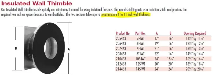

I am looking to go with the supervent pre-fab chimney from Lowes, but I see that the wall thimble adjusts up to a maximum 7" thick wall. What do you do if you have 8" thick walls? Do they make an expander piece or a bigger thimble?
Do you have a part number? The thimble should telescope.
  • [Hearth.com] Question about wall thimbles
