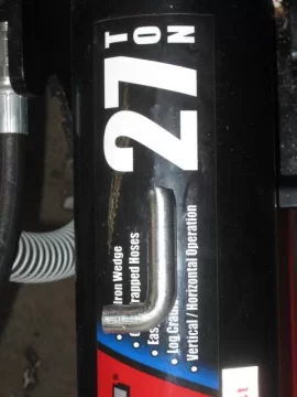

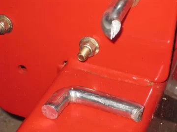

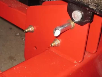

here's some pics
  • [Hearth.com] quality control in 27 ton troy-built

wow its hard to believe that thing could break! but there it is........
Never even second guessed it beforemyself, had to be some imperfection- its probably made in china. they need to use some good U.S forged steel. Anyways just really wanted to give a heads up to everyone on here.

I just saw the pic of your cylinder. I see it too is a trunnion mount like the 20 ton. Still though, it being a larger cylinder would be heavier and so more top heavy. I'd hate to see the pin let go and the base hit you in the chops. Bet that would leave a mark.
My guess is that the steel rod was not properly heated before it was bent 90° &/or not heated after it was bent to relive the stress.
Also the bending press mad a sharp inside corner, this also weakens the steel at the stress point. (notice the 90° that's not broken)
When you get your new one, heat it up to a dull red glow of the metal with a propane torch in the 90° bend, & let it cool (don't quench it).
This will relieve the stress & make it less brittle. Should help, but next time you'll remember to release the lock first :) (experienced now)
