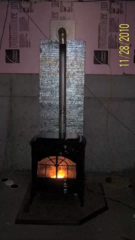

I purchased the stove in Feb of last year and installed on the east basement wall a little closer to the north end so later when the basement is finished it will be warm and toasty. I also wanted supplemental heat mainly in case of a lengthy power outage we could at least have one comfortable area in the house. I mainly intended to run it when the temp is below 30 outside but keep finding myself firing it up. I am working on insulating the basement walls and it makes a huge difference.

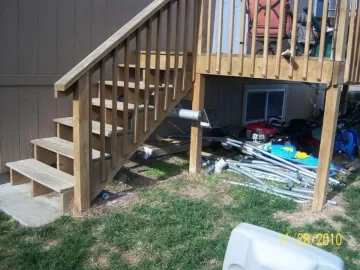

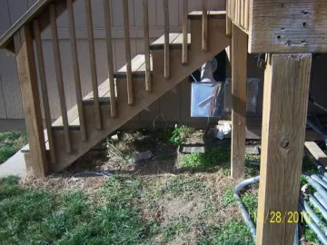

The pipe exits a knee wall outside under the steps of the back deck about 30" off of the ground level which eventually will be lower yet after some yard work. I will get a pic of that later.
Please excuse the poor job of picture resizing and the trampoline parts under the deck. I wanted the stove further north but the vent would then be right by the heat pump. I guess I could move it over there and run the vent vertical if a window doesn't cause an issue.
