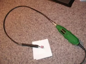

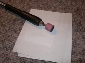

Groundhog...I use a Dremel (clone) tool to grind the carbon off the burn pot door......much easier than scraping with screwdriver or chisel.....I agree that the burn pot door sticking is the worst part of the Quad...but that's hardly a deal breaker. From what I read of the HastingsI think it has the VersaGrate which is somewhat a self cleaning design but there have been some complaints on this site about themn being noisy...I can't imagine that they would be that annoying though....I really like the look of them!!

Thanks for the tip on the Dremel, I'm all over that. Maybe you could post a picture of the attachment you use? Certainly not a deal breaker, it has probably jammed up at most three times in the last year. I do spend a lot of time scraping the floor with various gasket scrapers to avoid the jams but it is not even close to a deal breaker. I really need to get picky to find any faults with my Quad Castile. It's been great.

I am attaching 2 pics of the Dremel type tool I use. I like the flexible shaft as it makes it easy to work in the burn pot. The grinding tip is approx 1/2" diameter cylinder with a flat bottom...I use the flat surface against the bottom of the burn pot.....just lightly so I don't actually grind into the metal of the pot!!...By the way this wasn't my Idea...I found it right here on Hearth.com!!

Thanks peirhead, my endless search for the perfect scraper may be over. Hey not to get off topic but I have one more question, have you ever put the smartups to the test? I would be curious how long the run time is on that 1400 with the Castile and if it can handle an ignition cycle. thanks!
