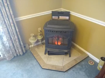

My Quadrafire Castile freestanding stove has been acting up lately. Cleaned it out and noticed when I restarted it, the auger is making a buzzing noise. It doesn't make the noise when it first starts feeding before the fire starts. The noise starts after the green indicator light goes on and it starts the feed cycle. It gives about 5 or 6 quick pellet feeds then a long feed. This cycle continues like this throughout the burn. I guess its the normal feed cycle. The noise is evident very slightly during the quick feeds but more pronounced during the long feed(approx. 2 or 3 seconds). Its doesn't always make the noise. I emptied the hopper and tried to turn the auger by hand and it is tight. I ran it by pressing the reset button and it didn't make the noise. I have been monitoring the pellet feed and it seems like the quick feeds aren't always dropping pellets. Sometimes the stove shuts down due to lack of pellet feed(I think, because it usually happens overnight). I just ordered a new auger motor online, but wanted to check to see if I am doing the right thing by replacing the motor. The stove is 13 years old and the original auger motor.

ordered a new motor online due to the huge price difference between getting it locally or waiting for it. I paid $157 vs $220 locally. Luckily its been warm enough here that we don't need 24/7 heat from the stove. Its still making noise at different times and shutting down at times due to lack of pellet feed. I emptied the hopper and checked for clogs in the auger chute and feed chute. All looks good. I hope to get the new motor in this weekend. Any tips on removing the old motor? It looks straight forward. My only problem might be getting in there due to the way my stove sits 45 degrees in a corner. Hopefully I wont have to disconnect the vent tubes, they are a PITA to get apart. [Hearth.com] quadrafire castile auger motor failing?

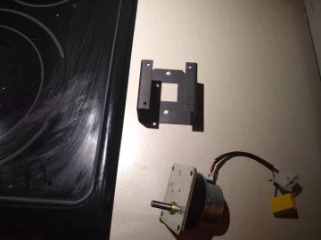

[Hearth.com] quadrafire castile auger motor failing? Going to replace the feed motor tomorrow. Looked at the new motor and new bracket that came with it. The new "simplified" bracket looks different than the original. There no screw holes for mounting the bracket to the stove. Is it necessary to put the new bracket on or just use the old one? I wont know until I get the old unit out tomorrow if the new bracket will work.

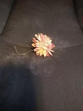

Just got finished installing the new feed motor. Took about 1 hour. The new "simplified" bracket that came with the replacement motor wouldn't work, it was the wrong shape and size and it didn't have the same mounting holes for the 2 screws to attach the unit into the stove. Pulled the old auger assembly out without having to remove the control box. It was a tight squeeze. I did have to disconnect the exhaust vent pipe to move the stove out and get access to the right side. Once I had the auger assembly out I noticed something weird looking inside the auger feed chute. Pulled it out to see that it was a plastic flower with a wire stem. Somehow this must have fell into the hopper or the 5 gallon bucket I use to fill the stove with pellets. This may have been part of the problem all along. Since I already had the new motor and had everything apart I thought it would be foolish to not put the new motor in, since the stove is 13 years old. Cleaned everything up while I had it apart and installed the new feed motor. Fairly simple repair and wire connections were easy with new wire harness that came with the new motor. One plug into the motor and 3 wires color coded(white, black and red) at the other end. I am a remodeling contractor and these types of repairs don't bother me too much. I do most of my own appliance repairs. For someone with mechanical ability and DIY experience, this would be a medium difficulty repair in my opinion. Ran it through 2 cycles so far and all seems to be good. Here s the flower I found in the auger chute all the way up at the top just below the motor mount.

Not the first thing to be found in an auger, and not the last. Been stories of all kinds of weird crap found in there. lol Glad you were able to fix it yourself and save some coin. At least, now you have a spare auger motor. Strange that it came with that bracket. You sure it is a quad motor? kap
