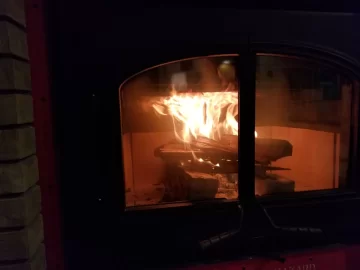

This morning's fire. Just a small load and the acc controls open I got a very hot fire very fast. It got up to 800 in no time at all. The fan never turned itself on. That seems wired to me. I turned it on manually and it brought the temp down emidiatly. Is there a way to get the fan on sooner automatically? It did however clean alot of the black off my glass.
Most concerning is how hot the double wall chimney pipe is. It will burn my hand instantly. Is this normal? What pulls the air up through the air cooled chimney? Its -11 now so the air cant get much cooler. Does it matter that I ran the air kit below the fireplace? I'm thinking air is not being drawn up the chimney. Thanks for helping.
Congratulations on your first burn! Your placement of the thermometer is good. I angled mine just a bit to the side for better visibility. I just shine a flashlight in and can see it fine. One recommendation is to secure the thermometer with some wire around the stovepipe. Over the years the magnet in mine has a weakened from all the heat. This will save you from having to pull the fascia off unnecessarily.
Another adjustment I would recommend to do before you get to far is to tighten up the snap disc holder. During my first burning season, the snap disc was temperamental. From a totally cold start, it would operate as expected. Relights where the snap disc had cut the fans off but the box was still warm would rarely activate the snap disc.
QF sent out a repair tech to replace the disc. Once we had accessed it, we saw that there was a metal bracket/clip that held the disc against the bottom of the stove. We could see that when it was warm there was a small gap. We decided that the heat would expand the metal of the clip and create the gap. So, we gently bent/formed the bracket to make a tighter fit. I have had zero issues with the disc since.

Well seasoned wood is always the rule. Seasoned wood, cleaner glass. Questionable wood, dirty glass.
My glass stays generally clean. It does build up a little coating of ash over a week or two. Then I clean it well with newspaper dipped in water and ash. If I do a really full load and the wood is close to the door, I get black deposits. A nice hot sustained burn will take care of it. then it is just fine ash adhered to the glass.
