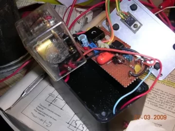

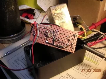

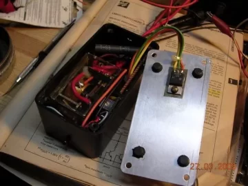

Hey Rainforest... welcome..... I have the free standing cb1200 and had similar observations as yourself. My snap disc for the convection blower is at the right at the back of the exchanger. I used a remote turkey thermometer to discover that the 'output' of my exchanger tubes reached 300 deg before the convection blower would come on.
It takes 2 minutes for the flame to catch hold from a dead start. In another 2 minutes, the output of the exchanger tubes was 80 deg and above from a cold start. I made a 4 minute timer (using a 555 timer) that was triggered by the thermostat coming on. After 4 min, a relay which is in parallel with snap disc 1 closes and starts the convection blower.
By the time the thermostat says the room is warm enough and shuts off, snap disc 1 has already come on by itself and now holds the convection blower on till the exchanger cools down enough (which is around 93 degrees at the output of the exchanger).
I was thinking the same as you..... that I was wasting heat ($$) by not getting it into my room as soon as it was available. IMO, the snap disc #1 is located too far back on the exchanger (which is also lower, and we know heat rises to the front as the exchangers are on a slope up to the front).
Anyway, had fun experimenting and making the circuit. I built it in such a way that it can be unplugged from the stove in a matter of minutes without altering the stove circuitry itself. I would have moved snap disc 1 but stove is still under warranty and the bracket holding it is welded firmly to the rear of the exchanger. ........cc :cheese:

.....here's what the final product looked like before I paralleled it into the stove..... cc :)
