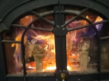

I think we need pics.
With good wood, you can shut the door immediately after lighting. It takes me 20-40 minutes to hit 600 degrees depending
on what type of wood I'm using. How high did your temps get?
As I understand it, your primary air is wide open and your temps never reach 600 after 2 1/2 hours. That sounds like unseasoned wood
or poor draft. When you open the doors during the burn cycle, can you hear the wood sizzling or see drops of moisture coming out the
ends of the wood?
Pics would really help. Pics of your setup. Pics of what your firebox looks like after 30 minutes. If you can't resize the pics, you can email
one of the moderators for help in resizing.
The whole dryer vent looking chimney in front of a zero clearance fireplace begs for a photo. You paid 7k, so the installation should be good,
but that description nags at me.

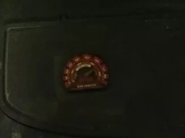

This is my firebox after an hour. And another photo showing where my stovetop thermometer is placed.
