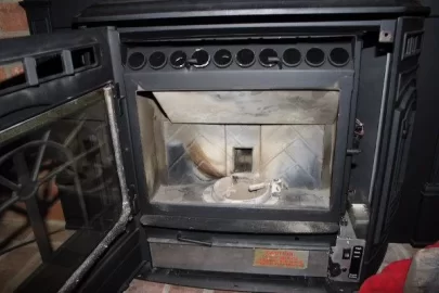

I got my Quad Castille Insert installed this year. I just want to make sure I'm using this stove correctly.
1. I've attached a pic. of the inside of the stove. It was all black originally, and now the back brick and the burn pot are white. Is the white normal? This is not ash. On the burn pot, I can scrape some of the white off if I really chip it off.

sounds normal for the paint. it will oxidize under heat and turn a ashen white.
its ok if that stove runs 24/7 its designed to run non stop.
Yep Beth, agree with MSG. White is good, run the heck out of it.
