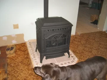

If you look at my picture below, you'll see that I recently did a full wall install. I also doubled every clearance requirement, 6" between the vent pipe and wall, 4" on either side for the hearth (almost 10" in front of the door glass) and 2" where the pipe went through the ceiling and roof. Always better to be safe then sorry.

  • [Hearth.com] Quad castile Installation Corner or wall?
