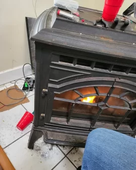

So I know this is a little late for you but I had the same problem. my power supply died but hopefully anyone else who searches when they have this problem they'll find this forum! I bought a $15 15 volt 10 amp power supply off of Amazon and wired it up and it works amazing [Hearth.com] QF MT Vernon AE Dead, Not Powering Up[Hearth.com] QF MT Vernon AE Dead, Not Powering UpAmazon product ASIN B08KRQT752
Please forgive the mess I tore it apart and am still putting it back together!
So I know this is a little late for you but I had the same problem. my power supply died but hopefully anyone else who searches when they have this problem they'll find this forum! I bought a $15 15 volt 10 amp power supply off of Amazon and wired it up and it works amazing View attachment 289299View attachment 289300Amazon product ASIN B08KRQT752
