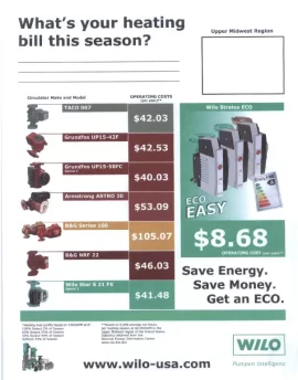

That pump has been replaced by the B&G NRF 22. That pump is shown on this comparison chart.
Either of the pumps you mentioned would replace that SLC and save some energy. If you have a system that uses zone valves these pumps will adjust and modulate to the system's needs.
