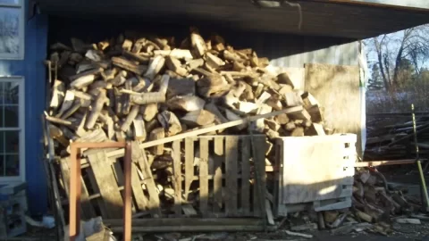

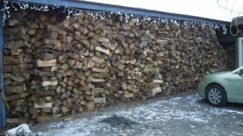

I do both. I much prefer the toss in as it takes a lot less time, the tractor can do a lot of the work and their is zero chance of toppling. The challenge is the side loads. If you could come up with something like an old wrought iron fence so that you can maximize the use of the space and the airflow, I wouldn't stack it.
  • Properly splitting and stacking oak, pecan, hickory, and ash
