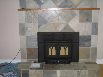

I've spent some time digging through the forum on how to run power to/through the fireplace and connect to the insert so I don't have to have the power chord exposed. I had a Jotul 550 installed last summer and enjoyed it all last winter but the wife wants the power chord and extension chord gone this year. I'm trying to figure out what is the proper way to make this connection. I've got a single level house with a crawl space and i assume I would drill through the bottom or lower side of the firebox and run flexible steel conduit/wire through the hole and hardwire into the blower (remove the original power chord). I would then run the wire in the crawl space up through the wall to the nearest outlet. Does this meet electrical code?
