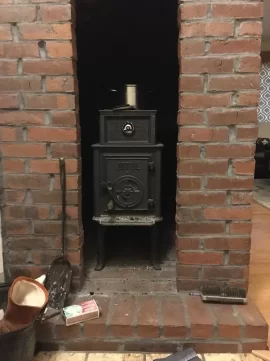

Good morning all. Hoping someone can teach me a little bit about proper damper usage with my setup. I’ve attached pictures below of the stove and the setup. Those aren’t cracks in the ceiling FYI, spider webs. Also, that is not a brick chimney it’s just a brick enclosure that surrounds the fireplace. All houses in this neighborhood were built with these; I think the idea is that the stove heats the bricks. I’m surprised at how well this stove heats our house.
Last winter I burned some awfully wet oak so hot temps weren’t an issue. This year my wood is all measuring 17-22% mc on the freshly split face. This is great, except now my fires are getting incredibly hot and I don’t feel like I have a lot of control over them.

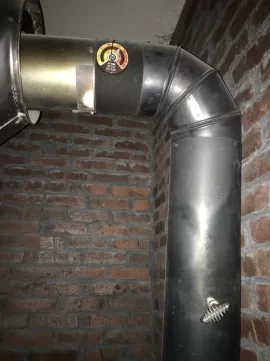

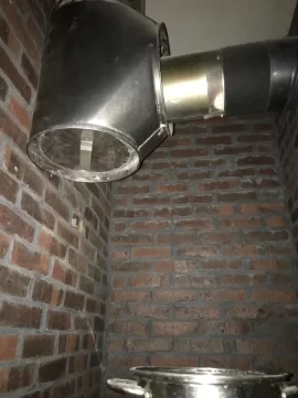

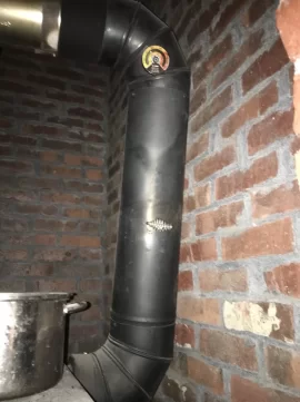

I have one magnetic Thermometer about 12 inches above the flue damper and another on the top of the stove (let me know if there is a better place to put these) I’m guessing I have single wall piping where the thermometer as I can measure such high temps with it?
When I make a fire I close the damper down to just barely open right after it really lights (10 min or so) and I close the circular air intake to about 1/4 open and even then I’m getting flue temp readings above the damper of 900+f. It seems the only way I can get that down to a moderate temp range is if the fire has died down a bunch or I close the damper completely. Is this something I can do? Close the damper completely? I am reading conflicting things about this.
