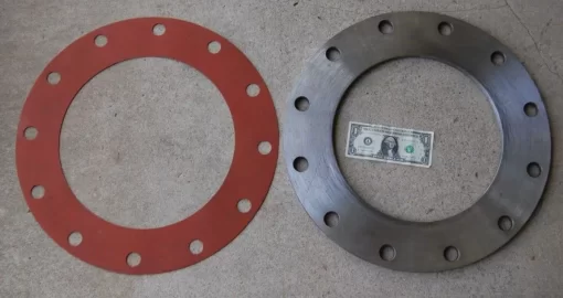

Phil,
I got a flange and gasket from this place.
(broken link removed)
I think it was $65.00 for the 12” flange and $25.00 for the gasket. Here’s a picture of them.

Hi Ron, thanks, I saw that in your post, unfortunatly I cannot mount my tanks standing up, I think thats the ideal way as there is less surface area on the top for heat loss, IE insulate the smaller top area and sides well and vertical mounting will have less heat loss. With it like that you can weld yoru flange on the bullet end and get a easy fit. I will need to mount mine on the curved side so will need a flange that has a neck so the flange sticks out some. I know nothing about this, can a welder aquire and weld on a 6 in piece of pipe to a flange like you have? Then weld that onto the tank? I was looking for a flange with a neck, which are alot more expensive and they are smaller sizes what Ive found so far.
Have you also located a DHW coil to mate to this flange already??

Phil,
My welder is adding a short riser between the flange and the tank to make more room for the bolts. I don’t see any reason why you couldn’t contour the bottom of a riser to the radius of your tank. In fact that is what I was originally going to do before I decided on vertical tanks.
Ron
So Ron, hes welding on a piece of 12" pipe to form the riser? Also, have you found a source for a DHW coil that will bplt up to this flange? Ive found a couple of sites that sell DHW coils but not alot of info on the bolt patterns. Heres one with several round sizes available.
