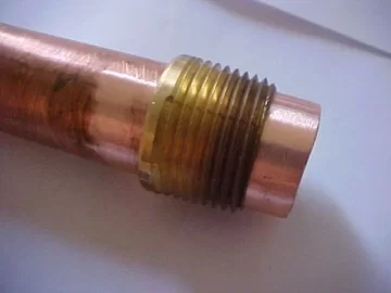

Another option is to buy a urinal adapter. it is a brass fitting that 3/4 or 1" copper tube slips through. Solder it onto the pipe and build a dip tube. It is a little tricky to tighten, easily squeezed out of round.
Consider the 1-1/4 port for a dip tube and pair together the 3/4" if you need to flow that much GPM.
Here is a picture of what I call a urinal adapter.
