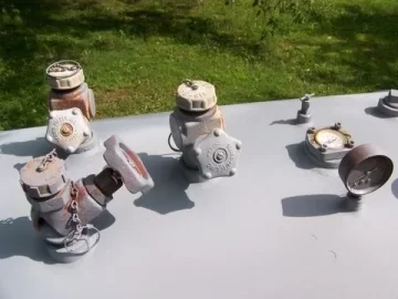

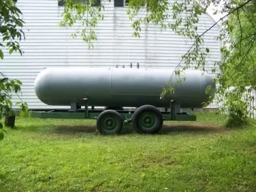

Sorry it took so long to attempt to post pictures. It's been raining evey day for weeks. Attached hopefully are pictures of the freshly
primed tank. Its dimensions are approximately 16' long by 42" wide. All the fittings except the 2" drain fitting are located in the top
middle of the tank. I have removed the cage, essentially a double roll bar that protects all the gauges and pressre relief valve from the top. Still have to figure out how to get it off the trailer and into the garage.
Mike
