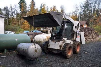

Hello all, I purchased a 150 gal. lpg tank im filling it with water and 1/2 gallon of bleach right now . Is a half gal. of bleach enough and how long should I soak it for.
I will be using this tank as a primary loop / buffer tank . I will plumb in house loop which will supply dhw ,infloor and base board. shop infloor heating and dhw . And also a supply and return to storage .
Are there others on here that have plumbed this way and if so ,can you give tell me what i need besides supplies and returns from the heat loads and storage .
Thanx
Dale

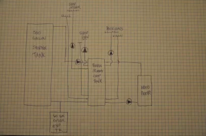

Here is a rough sketch of how I think I want my primary and storage tanks piped.
Would it be better to have them plumbed in parallel.
Should the circ pumps be on the supply or return side.

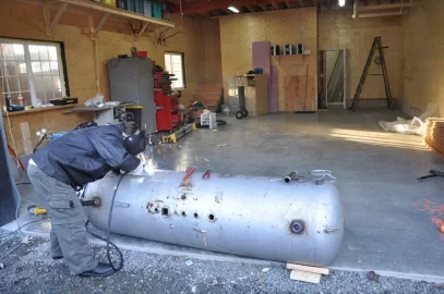

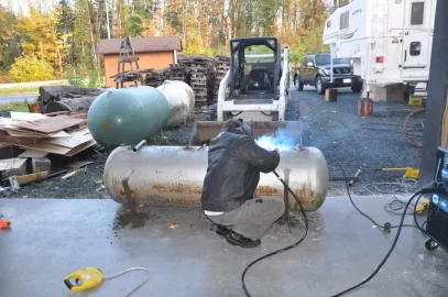

Some pics of a friend welding fittings on the primary/buffer tank
  • Propane tank cleaning and design for buffertank primary loop.
