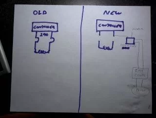

OK I'll take a stab at showing you my system.

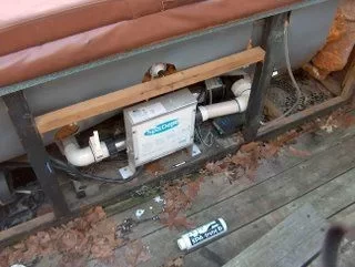

On mine I have a circ pump with 2" PVC pipe that goes through the electric heater. A sensor monitors the water temp and turns the 240v heating element on and off. I removed the two jumpers that connected the 240 to the heating element. I ran a wire from one side of the 240 to a 110volt relay and a wire from the neutral to the other side of the relay. So when the controller thought it was turning on the heating element it was really turning on the relay which is acting just like a thermostat. Word of caution here. On my system only one side of the 240 was switched, the other leg was always hot. make sure you get the switched side. (see bad drawing)

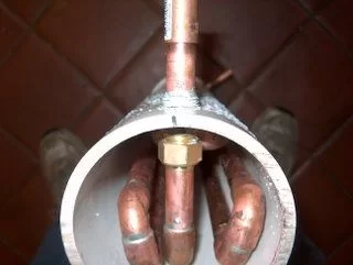

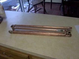

Next I built a heat exchanger similar to Nofossils. I took 24" of 4" pipe found, some connectors and threaded them through the the wall. I then made the heat exchanger out of 1/2 copper pipe. using a bunch of 90's and connectors to fit the pieces I threaded through the 4" pipe.
I'm having trouble putting the pics in the right order, but you can see a before pic. two of the assy, and one of the final unit installed.
I sealed the unit up with 4" to 2" reducers. I took out a section of pipe from the pump to the heater.

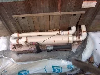

Using the appropriate number of fittings a pipe cobbled up the finished unit pic 4 and installed it back between the pump and heater.
Finally I ran 3/4" pex from my boiler to the heat exchanger just as if it were another zone.
My thinking was that I had not done any irreparable damage to my hot tub I could always put everything back the way it was if I wanted.
Everything except the relay came from Home Depot or Lowe's.
I insulated the pex portion that ran outdoors. As I said before it only runs about 90 second if the boiler is hot (170). longer if things have cooled down or if its competing with 3 other zones at the same time. The heat exchanger is too big to fit under the tube so I have it under the steps with plenty of insulation.
