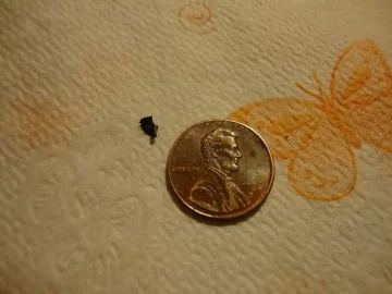

I started taking things apart on my hydraulic splitter and found a ball check that was not moving. I jimmied it around with a toothpick and pulled out this metal shaving!
Now at least the slow-speed pump works. However, the reservoir still builds up a vacuum and the ram slows down a bit. Could this be because I monkeyed with the "adjustment" screw? I checked out a "hyjacks" website which had some helpful drawings - although I found it quite obnoxious. Evidently I am an idiot for messing with the adjustment screw. Although there was nothing in the owners manual that suggested that the screw should not be messed with. . .
