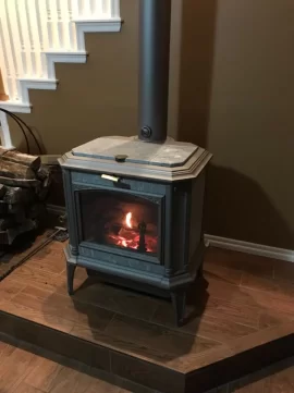

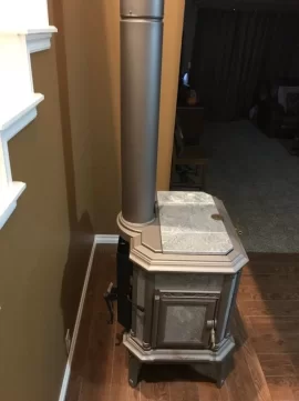

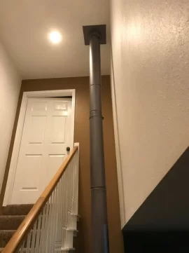

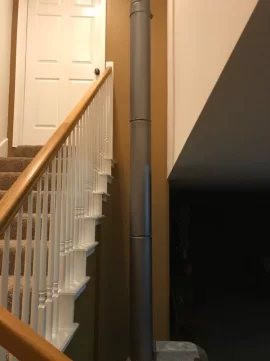

Here is my interior set up.

Very nice looking installation. Most chimney rods are flexible enough to get through a 15° offset. I've used them through 45° offsets, both from the bottom and the top.
I like your install! Can you remove the first pipe at the top of your stove? I am able to remove mine and I clean from the bottom up using a Sooteater. I don't like going up on the roof either....

I have a bucket that fits over the chimney pipe that I ducktape to the chimney pipe to hold it securely. On the bottom of the bucket I have drilled a small hole that the Sooteater rod fits through. The bucket catches almost all of the soot I've used this system now for 4 years and it works great!
