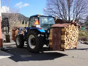

Last winter I had a local logging truck operation deliver me a load of Douglas Fir & Larch. The driver asked me if I wanted the load "wooded up" and I, of course, said yes!
"Wooded up" means over-full; ie. over the permitted weight for the scale. He didn't have to go over the scale in this case, so I ended up getting lots of logs to process - ended up being 19.35 cords!!

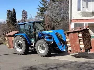

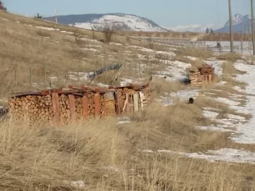

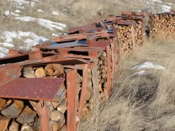

I palletized all the wood, and moved it up to the old Hydro access road near the top of my property. I moved 2 pallets at a time -one on the bin lift on the back of the tractor and one on the forks on the front of the tractor. The move was a total of about 600 feet. Never lost a piece of wood off any of the pallets in the process.

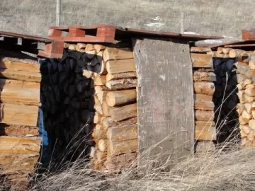

I ended up with 43 pallets of wood, with the average size being .45 cords.
I experimented alot with different methods of keeping the wood on the pallet as I stacked and moved it. Tried shrink wrap first - it worked, but the stacks didn't look too stable and I didn't want to have to pick up dropped wood and restack it. the 4 or 5 that I did shrink wrap made it up to the storage place OK, but the shrink wrap has since disintegrated and 3 of the pallet stacks have fallen over.

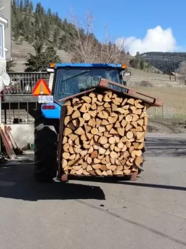

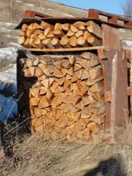

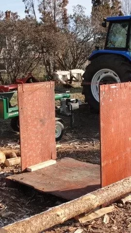

My "final" design worked very well; it consisted of a pallet on the bottom, 2 sides of 2x4 plywood with 2 holes drilled into each piece. The sides were nailed onto the pallet and 2 pieces of baler twine were attached through the drilled holes at the top. Then I screwed/nailed one or more pieces of plywood to the top of each pallet stack - creating a pretty decent roof.
My wood was all cut to 21" (for my Oslo stove). I made two rows on the pallet and left several inches between the rows. I stuffed the wood in as tight as I could -- most of the time you could "play a tune" on the binder twine which of course got very tight as I stretched it to accomodate the wood.
The wood is drying very nicely up on the hill. It gets unobstructed sunshine on good days and there is alway a pretty good breeze as well. (the hay in the adjoining field will quite often be dry enough to bale the day after I cut it!!!)

Here's another of the tractor with the bins on it.

Next winter, when I start needing this wood, I can bring a couple of pallets down to the yard, and place one on the back deck - just a few steps from the back door of the house. Sure will be convenient - and easy too!
nelraq, That is nice packaging. Could you take a picture of the contruction of your pallet boxes for me. I want to see how they are constucted not to come apart during transport.
nelraq, I really like your idea and how you moved the wood except for the shrink wrap idea. That would be bad because then the wood would get no air circulation so would not season well at all. The plywood is not so bad as it doesn't cover the whole side. Moving with the tractor is a big plus. Thanks for posting.

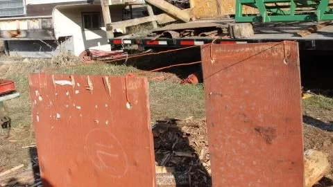

Here are a few more pics.

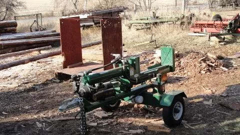

The first 3 show the construction of the pallet boxes. This was by far the best design that I came up with. Simple to build and it took a lot less plywood - note that there is no back with this design. BTW, I really lucked out with the plywood. The local fruit packing plant spends the winter months rebuilding their fruit bins. Any bin bottoms (ie. the pallets) and plywood sides that had any defects in them are put out by the road and are free to take. My only costs were some nails, some baler twine, and my time!

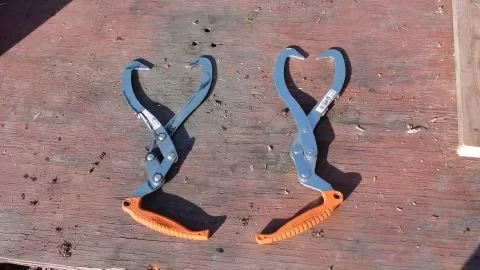

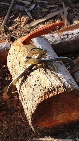

The third and fourth pics show the Timber Tongs. These definitely saved my back! I think that the hardest part of processing wood is the lifting and moving the rounds to the splitter. I got the tongs through my local Husquvarna dealer. I notice they are available from Bailey`s in the US as well. Certainly worth every penny I spent for them. If you are interested in these, I would suggest buying two -- because then you can pick up two rounds at a time and you are balanced as you walk with them. You can pick up pretty large rounds with these things. You can also pick up your split wood with them as well. A real time saver!
