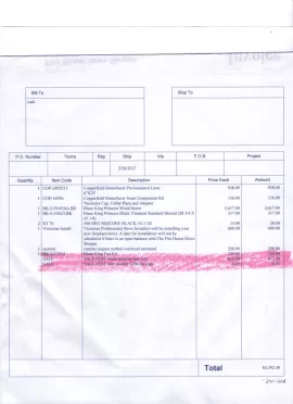

Got a quote today from a local stove shop. Guy seemed pretty knowledgeable. He is selling his floor-model Blaze Kings at 25% discount. I was intent on getting a free-standing stove for efficiency reasons, but he has mostly talked me out of it. Understanding how much modification would be required to my floor and masonry chimney gave me pause. The insert looks to be a pretty straightforward install, with only a steel plate and ember rug required 18" in front of the glass door. I upgraded to the insulated liner. He doesn't do block-off plates, but instead stuffs refractory insulation at the top of the chimney. Says his installed can do a better job up there since he can see to ensure he is filling all the gaps between the flue tiles and liner. As long as the airflow is blocked, I suppose it doesn't matter whether the blockage is at the bottom or top of the chimney. Anything else I should think to ask about before pulling the trigger on this? Think this will be able to heat my two-story house ? (2500 sq ft). Any guesses about the burn times I should expect on hardwoods on a 30-degree day? I've seen everything from 8 hours to 27 hours. 3 reloads a day would be fine with me, but 2 would be even better.
