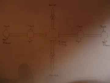

Thanks again EW' How about this? What if I placed a 4 way cross tee straight out from the middle tank. I was able to turn the two outside tanks toward the middle tank so that all fittings were grouped together in front the middle tank (on the bottom). A 4 way cross would equalize all pipes exactly and allow a port for retern line. The same thing could be done on top ,but pipeing woulb be a little longer due to top ports. The cross on top would also allow for supply. Will this work ? I hope it will because it would be simple to pipe. Then I would just have to establish where to come off for the zones.

Cool, and a new jungle-gym as bonus! Just put a tee in one of the side legs at the top to pull load supply and another tee on the opposite bottom side leg for load return and you're done. The load connections wouldn't be perfectly equal, but the flow rate is presumably quite a bit lower, and the equal/symmetrical requirement is after all only a goal, not a show-stopper.

Like the idiot I am, I didn't take any photos of my manifolds when I was assembling them but here is a drawing of them. This drawing is of my hot supply manifold (hot from boiler/hot to the house zone) going to the top of my 4 tanks. The other manifold is for the bottom of the tanks which is exactly the same but without the circulators. All of my lines going from the manifolds to the tanks are all cut the same length and I get pretty consistence loading of all 4 tanks. The beauty of this setup is that the house zone doesn't care where it gets its water supply from....it either comes from the boiler (if its running) or the storage tanks. I made them from 1 inch black pipe.
*Edit* If you hook up using this method, you will need a way to isolate the boiler when it is not running as you want the water to come from the tanks. I'm using a motorized valve that only opens when the water is 187 degrees out of the boiler.

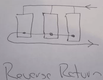

if you want equal flow thru all tanks, reverse return piping is another method. It does require more pipe and insulation.
Basically the first tank to get supply is the last to return. Some installers step the pipe size to get more accurate flow with less pipe diameter costs.

WOW THANKS FOR ALL THE IMPUT AND DRAWINGS. I like the easiness of the cross idea, but reverse return seems more proven for equal flows. EW states unequal not a total deal breaker,but I want to do this as efficient as possible. Here's the question? In hot water, describes reverse return,but what if the lengths on the top manifold do not equal the lengths on the bottom manifold. My top manifold will be coming out of the top of the tanks in a L shaped pattern, but my bottom manifold will be out of the side about one foot up from the bottom of the tanks. If I turn the tanks so the bottom ports are facing each other the lengths would be drastically shortened. Would long manifolds on the top and short manifolds on the bottom disrupt the flow and balancing?
The lines will only have to equal with each manifold that they are serving. The lines can be different length between the two manifolds, just make sure they are equal on the same manifold. The manifolds can even be different length. The water doesn't care where it is coming from, or where its going, just that it can move.

Your cross design offers the best/most equal connections for the boiler, which what matters most, but you'd be compromising somewhat on the load connections.
If you'll notice, my drawing above with shows both the symmetrically placed tees and the reverse return options, take your pick. With either the symmetrically placed tees or the reverse return there is a slight difference in the path lengths, but for as many millipascals difference as it would make at some point you need cut some threads and fit some pipe before snow flies.
