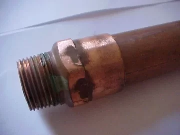

It is also possible to increase a 3/4 to 1 or 1-1/4". I buy copper adapters to go from 3/4 NPT to 1" copper, or 1-1/4" copper. Yes you will have a small pressure drop at that restriction, about what some reduced port ball valves have :)
Here is a 3/4 MIP to 1" copper adapter. I use these when I turn an electric water heater tank into a buffer tank for geo, or whatever. Connect the top two 3/4" ports on the water heater together with these fittings to get increases flow. Remember to remove the dip tube when you connect the H&C;on top, together.
