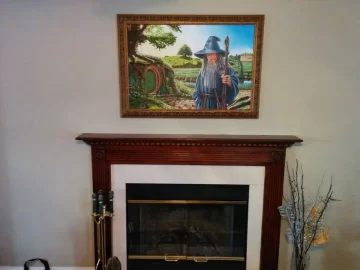

Oh as asked, here is a picture of my crappy fireplace now. I am photo shopping some different wood stoves to convince my wife it would look neat. And ya that's my wife's gandalf painting she had commissioned. lol
[Hearth.com] Pre-Fab upgrade (replacement) Any Options?
What is the opening height for the current fireplace? A freestanding stove will need a stainless steel liner in the chimney that matches the stove flue outlet size.
I am not sure, I will have to measure it when I get home. I assume they make stoves of all sizes that could work? In order to install a liner would they need to open up the entire chimney, or can it slide down into place?
Only a limited number of stoves have a rear-vent option and many of the larger ones are too high to clear the average ZC fireplace opening. Typically the liner is dropped down the existing chimney, no need to open it up.
