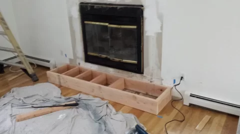

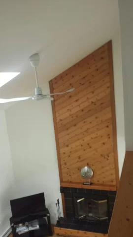

Below are two pics of the fireplace; one with wood that i ripped off the other in its current state about to rebuild the outside. Trying to figure what to do before i rebuild it.
Is it possible to have wood stove exhaust through current chimney avoiding a hole in my roof?
You could also rip out the fireplace and pipe, finish the wall as an alcove and put a freestanding stove with proper stovepipe in there. Budget-wise that would probably fall between hearth-mounted stove and replacing your current unit with an efficient ZC fireplace. The advantage would be you would not loose more room and use the existing chase for the pipe.
