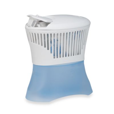

I believe I read on the label of Damp rid that you are supposed to open the package right? Does the stuff go all over the place?
i just put the bag in the holder. the water collected as per the design.
at one point i had to chip out the little drain as the water leaves behind some of the damp rid as it drains.
i hadn't read anything about opening the bag.
the holder is actually designed with ribs in the bottom to hold the bag above the bottom where the water drains.
opening the bag would defeat this design feature.
you can see the side venting too. the crystals would just fall out if the bag were opened.
though if i had known more ahead of buying this, i would have just got the 4 bag refill box and used a strainer over a pot and put the bag in the strainer.
