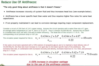

With glycol you need more pump and the glycol does not transfer heat as well as water. Here is an example of what 50% glycol does in a system.

The system was installed with glycol in it, so there is no water fill valve. Only reason for the glycol (as I recall it) was becasue there was a concern about the pex in the basement slab possibly freezing and bursting, but I really don't know the risk of that. The system is rarely unattended...we don't take long vacations and never go away for more than maybe a night in the winter. Circulator is definitely running, but I don't know how to measure the volume being pumped through it.
