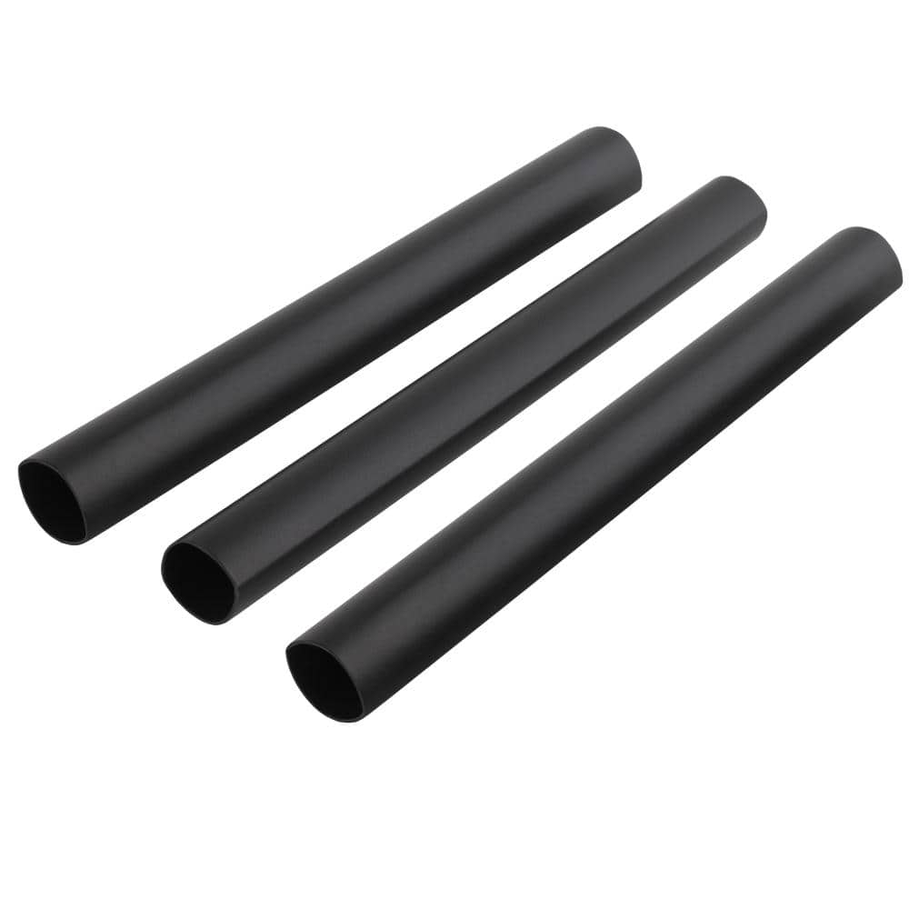

4. Heat shrink! - This is a good one but what size and where to get it?
Answer
Home Depot $4.82 - 1/2” 14-8 AWG JB
Plugged in the heat gun and cut a piece of heat shrink and bingo!
