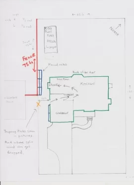

If you don't want to read my book below, just take a look at my property layout, and give me your thoughts? If you don't mind reading my book, here you go!

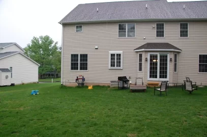

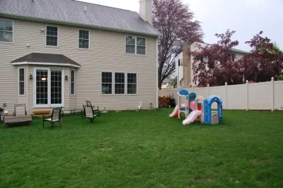

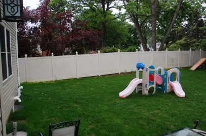

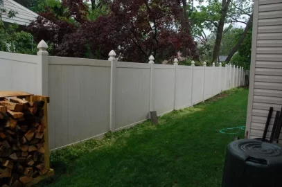

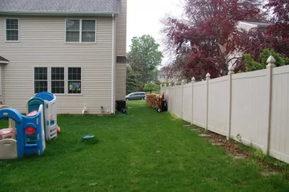

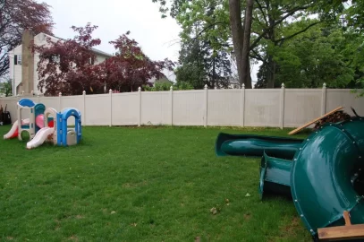

My suburban property is tiny..only a quarter acre. See the diagram below which hopefully gives a better visual. Yes, another one of those houses jammed into a small lot, but that's what we get around here. My stove is on the left side of the home. That side of the property has a neighbor's 6 ft tall fence running down the property line. Last year I stacked my wood along that fence. I built and used about 4 or 5 wood racks, each 8ft wide x 4 ft high x 18" deep. Three of my racks hold one cord. Being ignorant, I ordered a cord at a time, most of it unseasoned, so I will not make that mistake again. Thus, I just ordered and stacked 3 cords, which should get me through most of the winter. I'd love to store/season 10+ cords (I'm an Eagle Scout..Be Prepared!), but space is the problem.

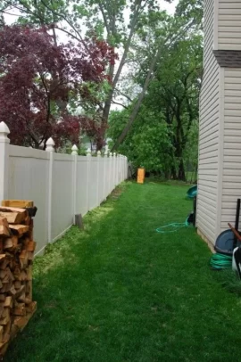

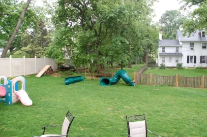

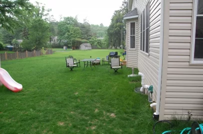

If I lined that fence from where it starts (near my garage) to my back property line, it's barely 75 feet. That would hold 9 of my 4x8 racks, and only 3 cords of wood. And for the first 20 feet of that 75 ft fence, the space between the fence and house is only 12 feet, so it may get limited sunshine and wind. Also, my boys playfort is slated to be pretty close to that fence in the back, so I don't want to jam things in there.

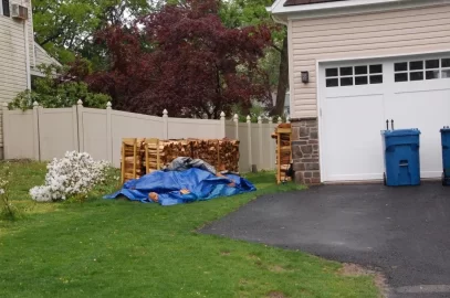

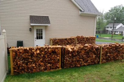

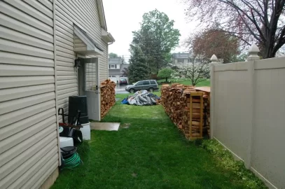

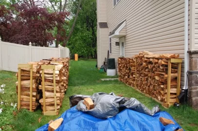

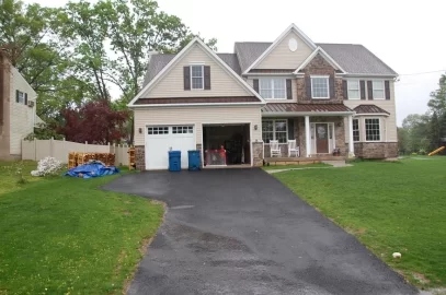

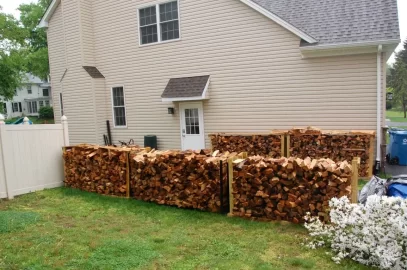

I just ordered 3 cords of pretty decent, and very clean (compared to last year's junk!) wood, which I stacked where the truck dropped it. You can see the stacks in the below pictures hopefully. On my property diagram, the current 6 racks are at the orange X. I'd love to store it here permanently but according to my wife, it's a bit of an eyesore from the street, and from my neighbor probably. I'm in suburbia remember.![Down :( :(](/talk/styles/default/xenforo/smileys/downer.gif)
So I was thinking of keeping some at the orange X, but most of it along the fence somehow. In an effort to not have to walk 50-75 feet everytime I need wood, I was thinking of either making the stacks higher (6 ft high would cut down needed stacks from 9 down to 5 or so) and/or making them 2 stacks deep would cut from 9 wide down to 4.5 wide. This would take up less fence room. So my current plan was to stack higher (6ft instead of 4ft) and double stack. This means I could get 3 cords in only 6 racks and not be too far from the garage door. See the blue racks along fence, in diagram. I know wood can fall, and also I'd have to reconfigure my racks. This is in a narrow area so sun and wind are a bit more limited than further back along the fence. Any other negatives? Do you think this is a decent plan?

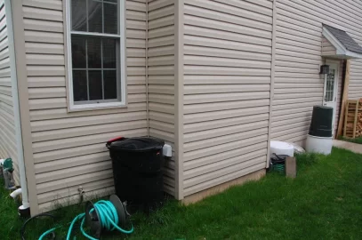

I also have an area against my house that is closer to the garage door where I bring the wood into the garage, then into the home. I know it's not ideal to store against the house, but these 2 racks sure are convenient, and they'd only be sitting there for about 9 months before the wood is used. Would you stack here?

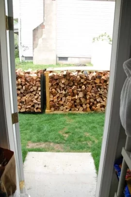

Another option is to bring wood from the backyard through the back slider door (see on diagram) but I like the ability to store a week or 2 worth of wood in the garage, during really lousy or cold weather. And when it's in the garage, I can basically go in the garage without getting shoes/jacket on each time I need wood.
So after all that, WHAT WOULD YOU DO, if you had my not so ideal property? I don't mind hard work, but taking 20 wheelbarrow trips per cord to the back of the property to store it, then taking 20 wheelbarrow trips back to the garage side door for each cord, and tearing up my yard in the mud/snow each time doesn't seem very efficient to me. And time is tough with 3 boys aged 6 and under. Thus my reason for wanting to keep it closer.
Also, would a wood shed be beneficial at all? I don't have much room for it close to the house though, and I figure the wood would season better with my racks (I plan to leave them exposed all summer, then put a piece of fitted 3/4" plywood over each rack once burning season starts), than stuffed in a woodshed. Agree?
Bottomline, I figure it's better to get as much wood as I can get, and even though it's not the ideal seasoning conditions, it's better than ordering during the burning season like so many do around here. So where would you put it all if you were me?
