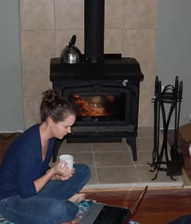

Recently, my wife and I installed a chimney, built a hearth (trim still to be installed) and installed a wood stove. I work for the local paper and wrote about our experience here:

The photo is of my wife Peg sitting in front of our new stove, soaking up the heat!

Just bought mine today! Can't wait to use it, hopefully my liner will be in by this weekend and I can get everything put together! :-) It JUST fits in my fire place.
Nice looking instal! I have to ask though, do you have enough clearance behind the stove and is the hearth large enough in front and on the sides?
Matt
I don't know what his clearances are, but the instalation instructions call for 14" to the back or the sides to combustables, and the floor need's 16" from the front of the glass and 8" on each side. For non-combustables it simply states to obtain clearances from the materials manufacture, which to me is a cop out LOL.

Pyro - about clearance. It's very close. I originally built the hearth for a smaller stove, then found out about the tax credit so bought a larger EPA approved stove.
It's 14 1/2" in the back (specs are 14"), 10 on both sides (specs are 8") and about 15 1/2 in the front (specs are 16").
So I am a little short on the front. I've been keeping an eye on it to make sure the floor isn't getting too warm, and so far so good.
